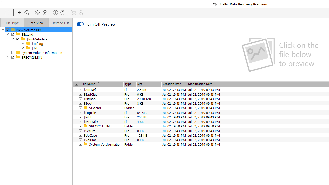

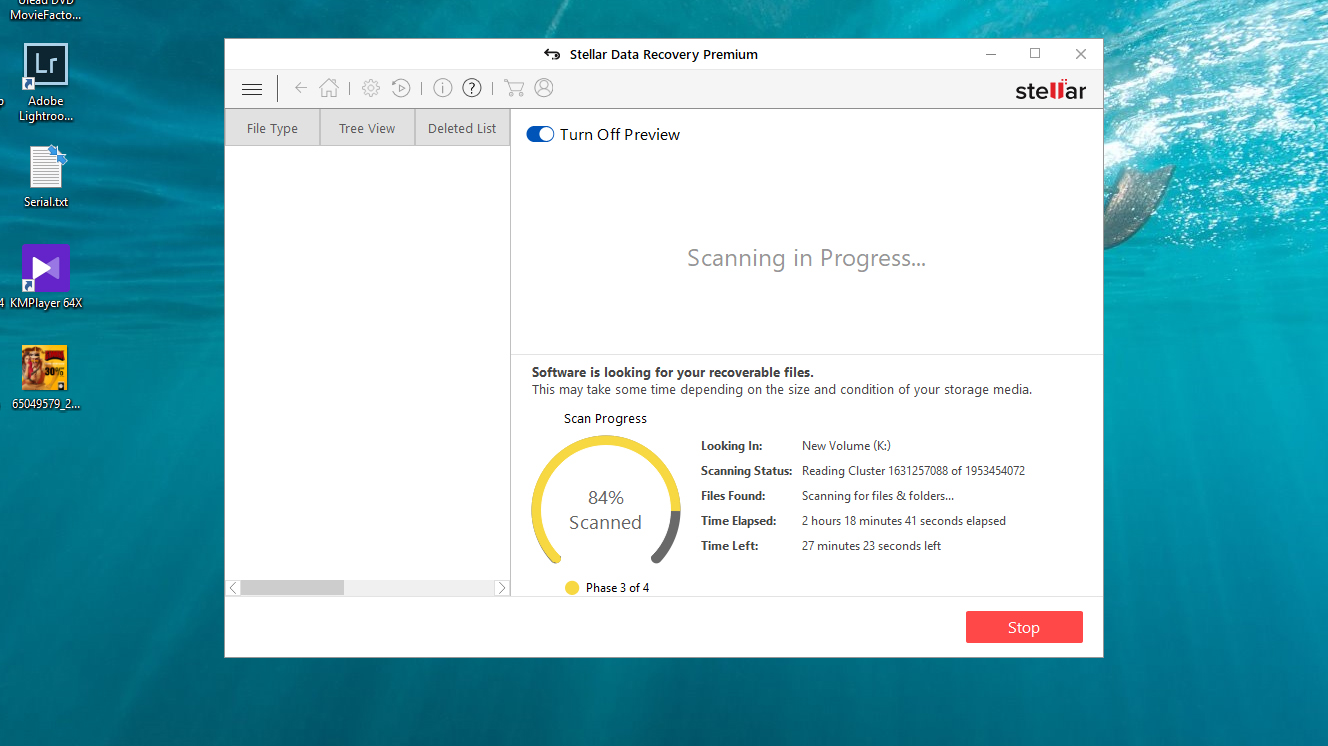

I was tried stellar data recovery software, but i have not found my data.
Stellar only recover $Recycle.bin
File Size: 58 bytes
and some txt log files.
But in drive there has 500 GB above data e.g. Images and camera video files, before formatting. and i really need my data.

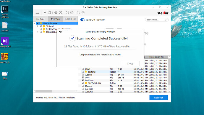

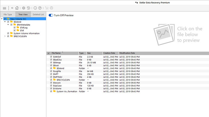

Dear Oliver,
Here is some snaps of after scanning complete.
Please guide me whats the solution …
Thanks and regards

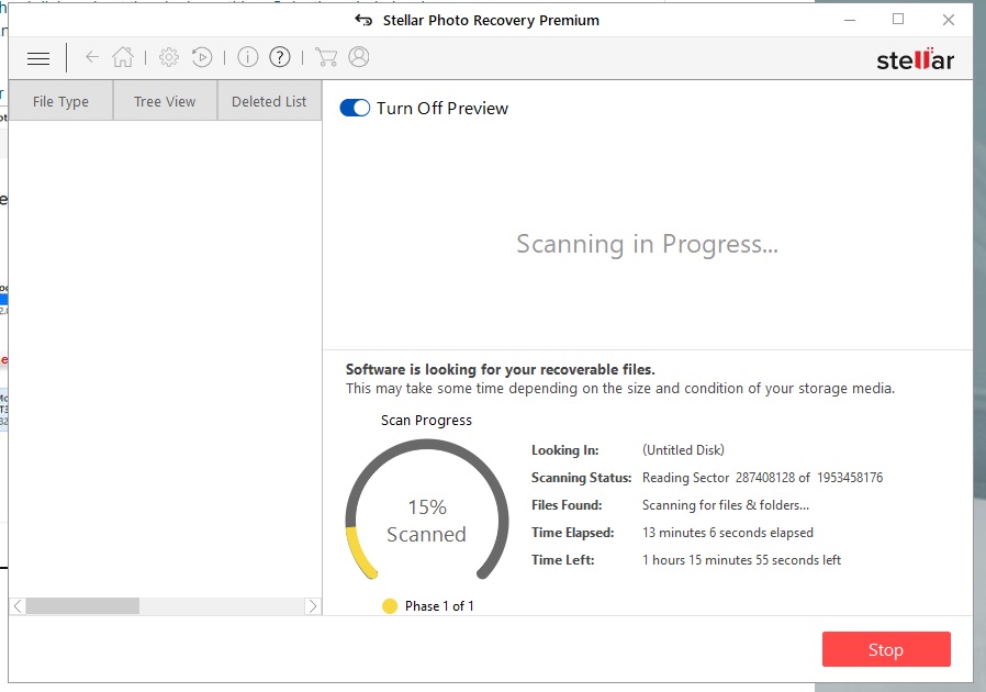

Hello Oliver,
I hope you are well.

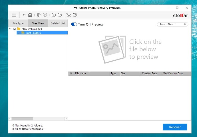

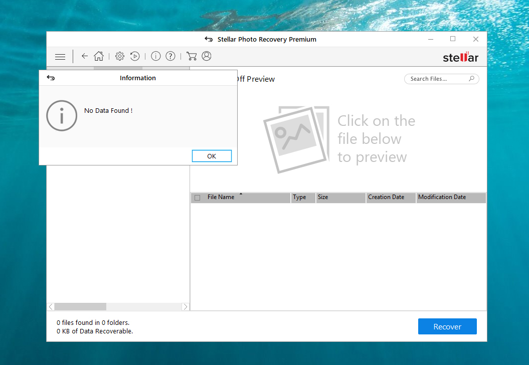

I was tried STELLAR PHOTO RECOVERY DEMO VERSION, but not found any file. can you suggest more ?
screenshots are attached.

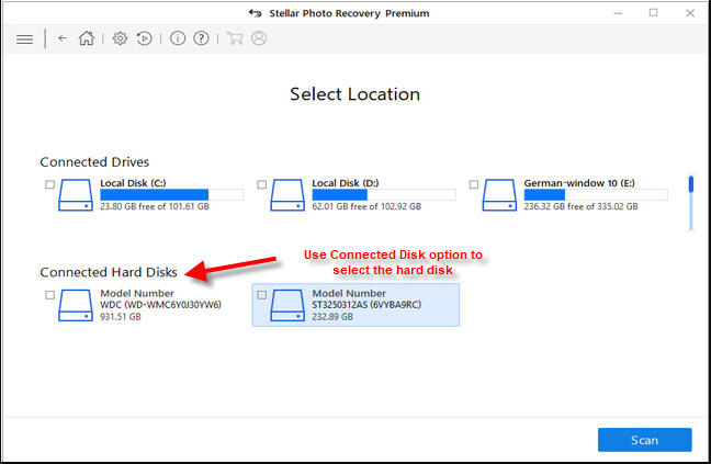

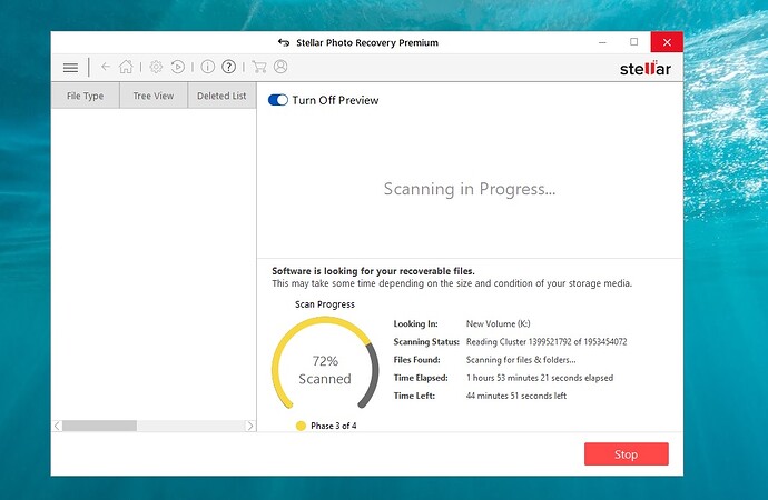

From the above screenshot it seems that you have selected the logical drive K; but in order to recover your lost data you need to select the whole hard disk and not the single partition. Selecting whole hard disk for scanning make software able to scan the entire hard disk sector by sector and provide all the recoverable files.
Please see the attached screenshot for your reference
Hope this will help you out!

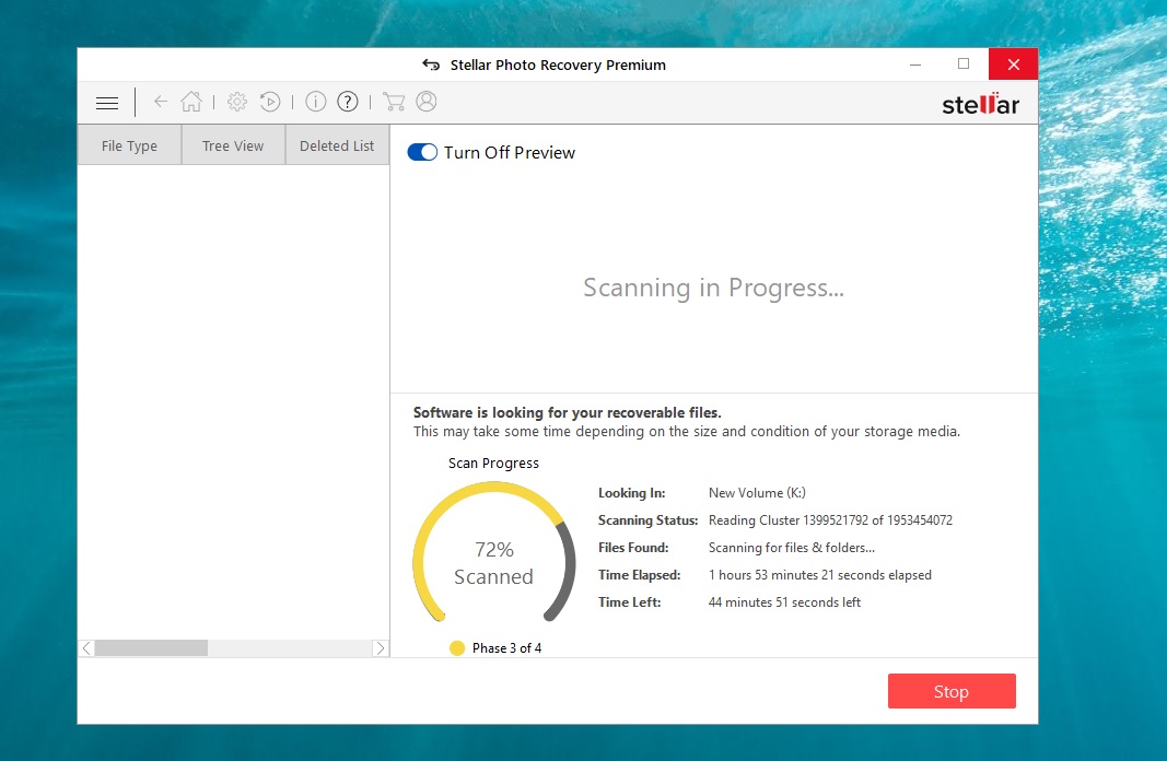

Hello Oliver,
I have tried the way you suggested, but unfortunately no files found .
Here is some screenshot.
Thanks and regards

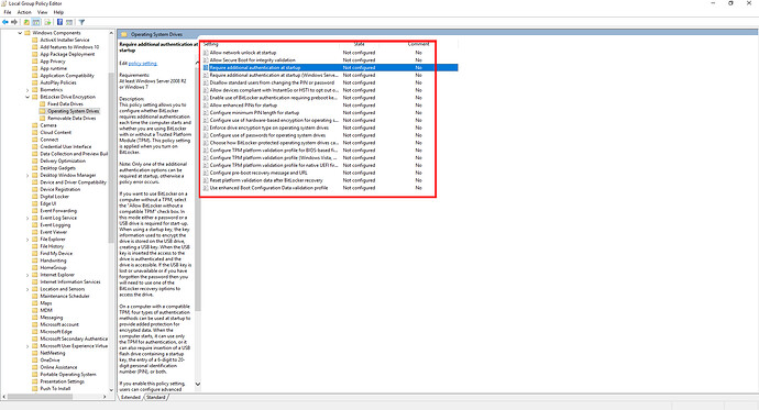

Could you please confirm whether the bitlocker is enable or not?
Hi Oliver,
Here is the status of Operating System Drives.
I need to change the status or not?
Thanks and Regards
