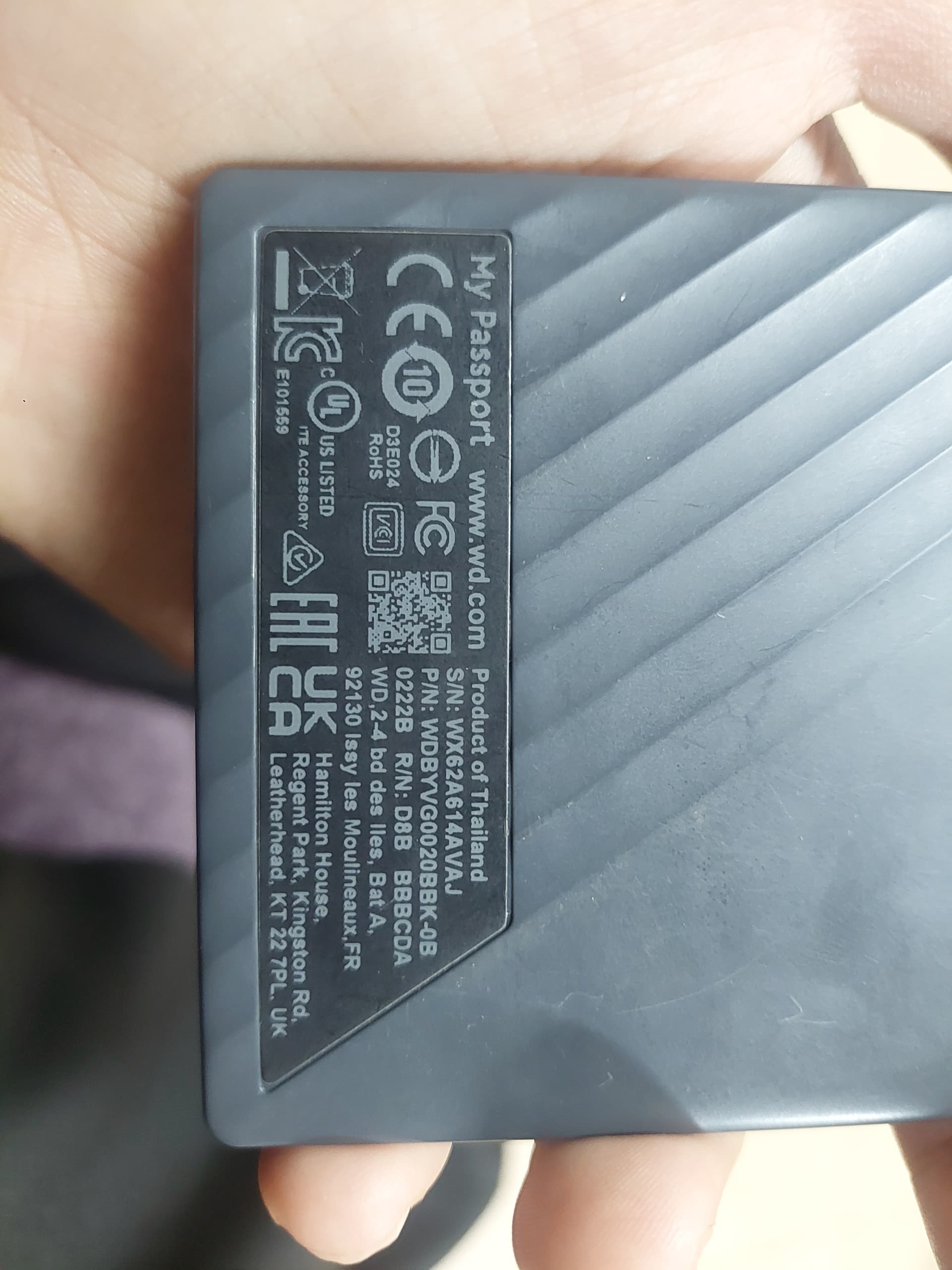

I’ll attach a photo of info at the back of the Hdd. And I really don’t understand what u said in the previous comment. Could you simplify it because I’m not that much hardware expert.

I’m sorry to hear about your HDD issue. Based on the model (WD624A614AVJ), the problem might be due to dry solder joints near the USB connector as said by @fzabkar , which is common in some My Passport drives. If the drive is under warranty, avoid opening it and contact WD support for assistance. If its not under warranty, then you could try reflowing the solder around the USB connector, but this requires technical expertise and carries risks. If you’re not confident, consider professional data recovery services to avoid data loss. Let me know if you need help with specific steps or further guidance
