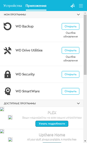

I have the same problem. I don’t use my cloud home, but I can’t update any software via WD DISCOVERY. The problem appears suddenly and I don’t know why.
How to find solution?
Or please fix it…
I use last verions of WD softwate.
I used WD DISCOVERY version 2.1.288 or 1.3.482. Problem appears in both verions.
It can be not only update problem, problem during first setup is the same.
“SETUP(UPDATE) ERROR - NETWORK ISSUE, PLEASE TRY AGAIN LATER”
OS is WINDOWS 10 64bit CREATION UPDATE.
In logs in c:\Users\USERNAME.wdc\logs\2017-10-27_18_errors.log
I see “CERT_HAS_EXPIRED” message
2017-10-27T23:55:45+05:00 ci=b72936e6-b757-4ed6-8698-af00e6a8521f error 204 in WD Drive Utilities: {“code”:“CERT_HAS_EXPIRED”,“RequestInfo”:{“url”:“https://s3-us-west-2.amazonaws.com/wd-portal-apps-prod/com.wdc.branded.driveutility/platform/WINDOWS/WDDriveUtilitiesSetup_for_web_2.0.0.25.zip"},“Version”:"2.0.0.25”}
If I try to download the file using any web browser with URL https://s3-us-west-2.amazonaws.com/wd-portal-apps-prod/com.wdc.branded.driveutility/platform/WINDOWS/WDDriveUtilitiesSetup_for_web_2.0.0.25.zip
I see error page that this website hasn’t protection.
If I click “more info”
First I see
Error code: DLG_FLAGS_INVALID_CA
DLG_FLAGS_SEC_ERT_DATE_INVALID
DLG_FLAGS_SEC_CERT_CN_INVALID
and try to open resource page:
My local MTS provider in Russia return, that the site is blocked without known reason.
I saw redirect to page MTC
