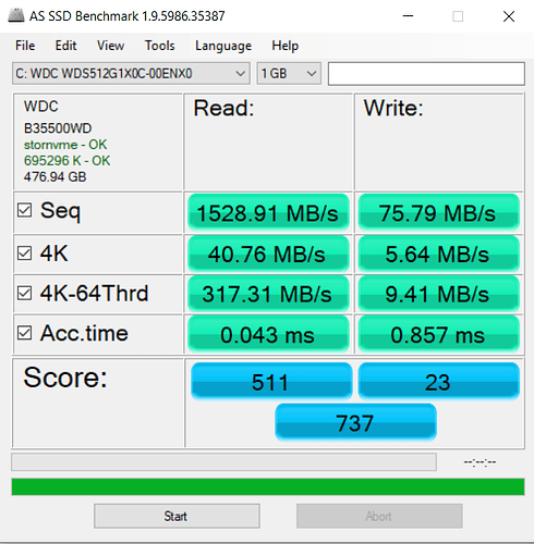

I’ve purchased a laptop containing the 512 gb model of the WD Black PCIe SSD. The read speed seems okay, but the write speed is 90% below the maximum speed.
I’ve repeated this test numerous times, and the max write speed I’ve gotten is 102 MB/s. This seems extremely low to me considering the spec said that it goes up to 800 MB/s for write.
Is this normal? If not, what should I look into for trouble shooting? I’ve checked all drivers through device manager already, but outside of that I don’t know what to look for.
What is the make and model of the laptop that came with the WD Black PCIe SSD? Have you checked the manufacturers website to see if any updated drivers are available?
If no updated drivers are available from the manufacturers website what driver is being used for the SSD? Is it the Windows driver, or a customer OEM driver?
If the computer has a Intel Skylake or newer SATA chipset you can try using the latest Intel IRST driver. That may have better performance than what you are seeing.
Although the website allows customization, which is where I chose to add the drive. The driver as listed in device manager is the Windows driver, and it has the date listed as 2006.
When I tried to install that driver, it gave the option to repair or uninstall, no option for install, so I think it was already on my computer. I went ahead and uninstalled then reinstalled it and ran the tests to no improvement. I also installed the chipset driver which also did not improve things.
Hi all. I’ve actually found the problem. I was poking around the BIOS to see if any options related to the drives were there, and I stumbled upon one referred to as ‘controller mode’ which was set to AHCI. The second option was ‘Intel RST Premium’. After switching from AHCI to IRST, the write speeds are up to 500 MB/s+ and read speeds are slightly higher.
Thanks for your suggestions, and hopefully this sill help someone in the future.
