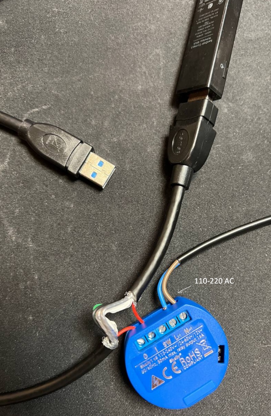

Here is SOLUTION for SanDisk SanDisk Connect Wireless Stick. You need smart relay with dry contact and USB-A to USB-A Female.
Carefully open USB cable in middle and find red cable(+power) and put it to your dry contact relay.
I used Shelly 1 wifi relay, cheap and easy to use.
Few hours later, i found much better solution.
Sonoff Micro + SanDisk SanDisk Connect Wireless Stick
