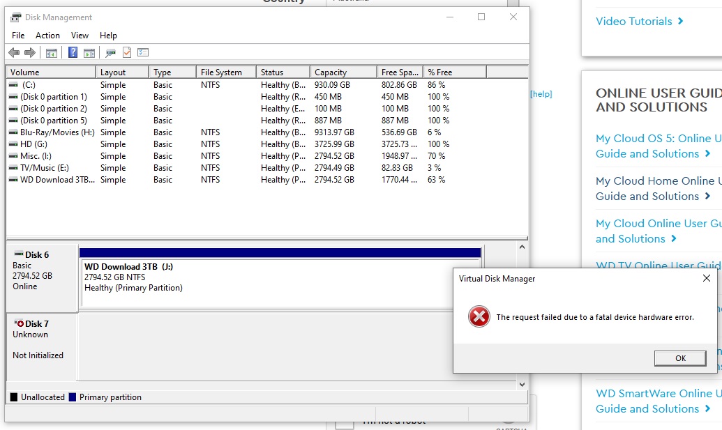

What does the ‘fatal device hardware error’ mean? This usually appears when the operating system can no longer access the hard drive or is unable to perform read and write operations upon it.
So what are the causes of this error:
Causes:
Faulty USB cable or a loose connection.
Too many bad sectors on the disk.
System or hardware fault.
The hard drive is dying.
And here are the below Symptoms for it:
Symptoms:
“X: is not accessible The request failed due to a fatal device hardware error.”
“Error 0x800701E3: The request failed due to a fatal device hardware error.”
“Virtual Disk Manager: The request failed due to a fatal device hardware error.”
