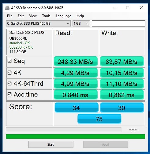

got this ssd a few days.
any hints why the performance is so bad in writing?

btw i tried another ssd ( sdssdp128g ) and get writing speed about 300-320 MB/s

so, i did that sanitize thing. now i get about 160-180 MB/s

ok, this is not a sata controller problem.
tried this ssd on another 2 computers with different sata controller - same problem
write speed allways below 180 mb/s, most of time 80-90 mb/s
