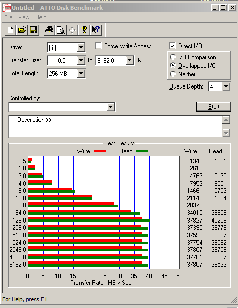

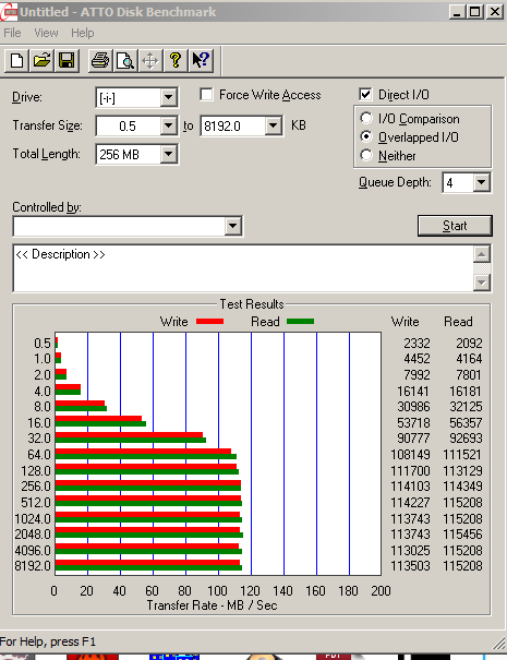

Here’s what I get on a 1TB MyPassport Ultra, system at idle–more or less ideal circumstances with a synthetic benchmark. Real file copies could vary considerably.
Left capture is USB 3. Right is USB 2.
