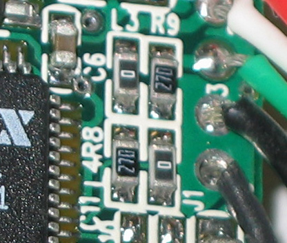

Great descriptions!  I also had the same problem with the BIG blob of solder on a refurb e250.  I dissected things a bit and came up with a way to fix mine.  First, the solder blob was a repair that connected the back headphone jack contact to a resistor (the thing you thought might be a transistor is actually a resistor of about 0.2 ohms).  Evidently the original circuit board trace broke between the headphone contact and the resistor.   On my Sansa, the solder blob had acturaly ripped loose the end of the resistor and destroyed it (the headphone jack had torque it).   I got the jack fully working again by just removing the resistor (use de-soldering braid) and adding a jumper wire from the rear headphone jack contact and the input side of the resistor thahat had been pulled.  I uploaded a few pictures to detail it a little…
 http://picasaweb.google.com/stickery/SansaHeadphoneJackRepair#5326628224637090706
 http://picasaweb.google.com/stickery/SansaHeadphoneJackRepair#5326624652983213314
http://picasaweb.google.com/stickery/SansaHeadphoneJackRepair#5326624667147332002
Not sure what value the resistor was adding… but since mine was trashed figure what the heck… nothing to lose.  Sound is fine out both ears - no static.
I suppose if your resistoris not trashed you can solder to the output end of it and retain its function…  the space is way tight though and soldering a little difficult…  mine solderiing was ugly but fully functional.
I was able to simplify my life a little as well by lifting the plastic headphone jack housing off the front metal leads (they were soldered to board).  the back headphone lead had broken from the board completely.  With it off, I then pulled that back lead out of the plastic housing of the headphone jack.  I was then able to do my soldering with the plastic out of the way.   I soldered the jumper wire to the board at the resistor contact and the other end to the rear headphone jack metal contact… pushed the lead back into the plastic housing and then pushed the housing back onto the two front leads…
Sorry, I did not get a few more in progress pictures…  but was really making it up as I went along and did not think it would work…  :slight_smile:
Hmm- I have 2 Sansas that need this treatment.  :dizzy_face: The resistor must be there for SOME kind of reason though?
-Is the volume any louder on one side?
-Does it cut out if you crank the volume up??
I too expected to hear a difference in the earphones… but can’t.  It cranks up without cutting out and the sound seems balanced side to side.  I also expected static or something… but again sounds fine.  And yes one would expect the resistor does something… maybe some slight change in frequency or something I can’t hear.  Dunno.
This was sort of a hail mary approach in that without a fix the Sansa was pretty useless…  I had only spent like $25 for the thing…  had no idea where to find a resistor and if I did at what cost and was not sure I was even skilled enough to solder in a new one.    So… what the heck… I did not have much to lose.
If the resistor is intact though… I would try to keep it and put the jumper on the output side and connect to the back jack contact.
stickery
2- e250 refurbs.
p.s.  I would be curious if someone else goes for it and and with what results…
Message Edited by stickery on 04-20-2009 06:57 PM
Sourcing SMT/SMD devices can be a real pain, both in identifying the device, and in the physical work.  I have worked with the wee beasties for so long that I think of numbers in color.  With SMT devices, we have wee numbers(usually), and those digits are often barely visible.
Working with SMD involves a proper soldering station (temperature is a big issue), a magnifying glass, and tweezers.  There are several really cool soldering machines using heated air, like the Leister.  The processor of the Sansa (200 pins) actually has no pins on the device (about 10mm square), we use dots of solder.
In this picture is a zero ohm resistor.  It’s there as a jumper, in most cases, a mechanical bridge.
Bob  :smileyvery-happy:
