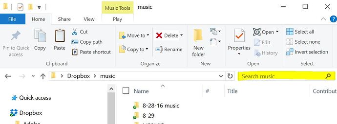

Kurt,
If you can pull up a file explorer screen which may look similar to this, this is an image on windows 10
and now go to the mail folder where all the files were recovered to.  In the search menu type in *.mp3 and let it search all the files to find the mp3 music.  When it pulls the list up select all of the mp3’s and move them to a single folder so you can find them easier.  Looking at the post above if you can not get your mp3’s via the icare trick you may be in luck via my other method but I would still rather you get the files via the icare dump just to be safe.
Hope this helps bro
