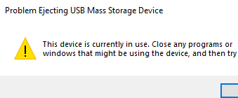

  • I tried the lwr rt task bar Eject, and got a message about a program using the drive.
  • I then exited my Explorer, thinking that it had a connection…nope, I’ve had this open when I’ve ejected (both task bar and rt mouse eject…Passport does not have a rt mouse eject).

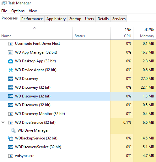

  • I found WD items running under Task Manager…so these may have a lock on the Passport devices in the background. You could End Tasks that should start up when you reboot the PC.

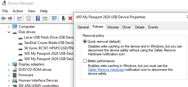

  • also read something about Removal of USB thru Device Manager. See Craig3 and Randy, in Feb and Oct… Cannot Eject My Passport - #12 by bc1144 - WD Software - WD Community
  • they point to a Device Manager, rt click the USB drive and Properties…next to Policies…
  • I have not tried this Better Performance, but implies that you must use the Safe Eject…need to do more studying.
One of these items may work…I have 2 Passports, so ending the task kills both from accessing the WD software, but should make them accessible for Ejecting or Viewing. Who knows!
Forgot to post the Task Manager Processes of the WD Apps. Memory is constantly changing so there is interaction with this and the Passport…must be why cannot Eject. Not sure if the Better performance option on Device Manager…I’m not suggesting that this would work…

ex672c…Thanks for the thread into this issue. After I realized that I too had the same, it allowed me to research the problem, in both this forum(back to 2015) and Microsoft. I believe that the fix is in the Win10 Device Manager option
  • assuming you want to always use the Safely Eject the Passport USB found in the inverted V tool tray by clock.
  • type Device Manager in the Win Search, open to Disk Drives, rt mouse to Properties then Policies. Change the entry from Quick to Better.
  • someone pointed to a Microsoft link that had a greater explanation. I did find some differences with info…however, it Worked!
    https://docs.microsoft.com/en-us/windows/client-management/change-default-removal-policy-external-storage-media
  • I had 2 Passports so I was able to play with this option. After modifying, the PC must be restarted in-order to activate. Specific E or H drive was not identified.
  • I even tried moving the chosen device to other USB ports, (Microsoft mentioned that it was port related change). I could not find this to be true, every port said,. Better Performance.
  • I was then able to Safely Eject the specific device, wait for the Pop-up msg about safe eject…

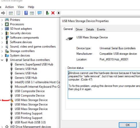

  • finally, under the Universal Serial Bus, I got this msg after Ejecting, but not Removing the Device. After doing so, and re-insert, I get a “Device working Properly”
