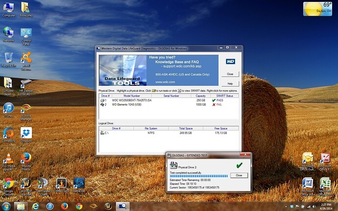

There appears to be a problem with the drive itself this is what I got when I ran one of the tools from the wd websitel
With a fail as a test result and having not been able to access the drive on 2 separate windows computers this is not even close to a solution. I mean I really need to be able to get into the drive to be able to use it and so far there has been no go no matter what.
It appears that there is a problem with the drive. If this is a new drive take it back where you purchased it and see if they will exchange. Or contact WD for a replacement. The Elements are a simple plug and play drive that doesn’t need software. I can copy and paste etc on mine with no problems.
