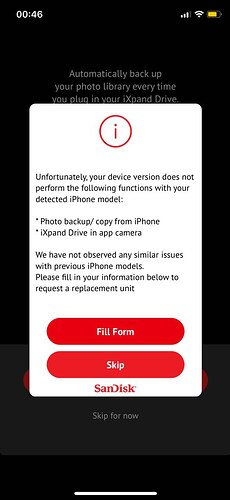

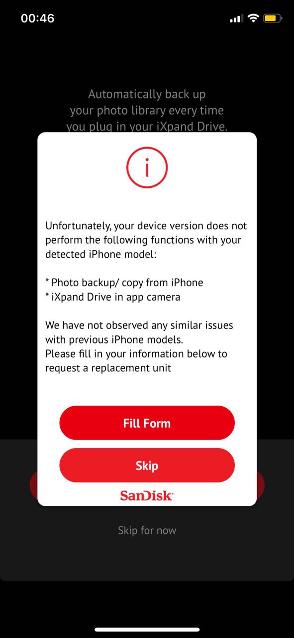

I am also on iPhone X on 11.1.2, I can view the files on my drive. However, I am not able to setup automatic backup for photos and contacts. Sad thing is I am in the UAE so filling the form as well won’t help me. Will there be an update anytime soon to have compatability for iPhone X? Error attached.
I have the exact same message.

If you are seeing the message in the post above it is a hardware incompatibility issue and the iXpand will need to be replaced. If there is no form available for the region you live please contact SanDisk support directly to get a warranty replacement.
