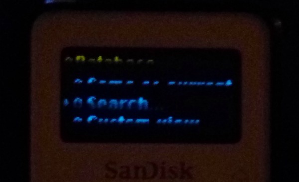

how i semi-borked whitey:
  • used it for a couple months
  • stopped turning on, one day
  • thought it died
  • turned it on after a couple months – nope
  • connected to pc, IT WAS READ BY MY PC, IT TURNED ON!!!
  • one problem, there’s like lines on the screen, it’s very noticeable when scrolling, and screen is a little dimmer, see pic for details:
can i revive these players without going to a technician? i bought them online knowing none of the stores here carries them. so, going to a technician only semi-crossed my mind. thanks.

update:
out of 3 mobile technicians, none of them knows how to fix the black version.
i’m currently using the white version lightly. for now, it’s usable by squinting my eyes and hoping for the best. i’m not touching the firmware yet in hopes it’ll last longer. that being said, thanks for the tutorial, black-rectangle, i’ll look into it when the screen screws itself again.
