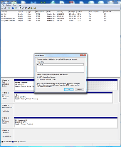

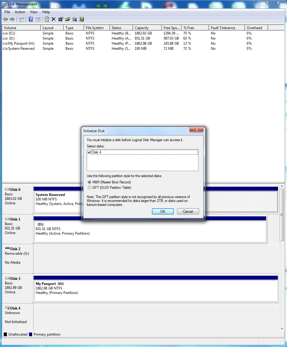

I plug the drive into the computer. It does NOT show up under My Computer. It DOES show up in Device Manager and Disk Management. See the screenshot attached.

In Disk Management the drive comes up as “Disk 4” and in Device Manager it is “WD My Passport 0820 USB Device”.

When I open “Disk Management” is prompts to “initialize” the drive. Another screenshot attached.
I haven’t really been able to really figure out if “initializing” is data destructive or not… I think I’ve seen it both ways by reading different forums.

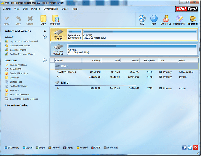

Reading several threads with similar issues lead me to install “MiniTool Partition Wizard”, but the drive doesn’t show up in that program. See screenshot number 3.

If the computer is asking you to initialize the drive then it means the partition is corrupted.  If you proceed and initialize the drive you will delete all the data stored on the drive.
It may be possible to still extract the data utilizing data recovery software.There are several kinds of Data Recovery software available. If you do a web search for Data Recovery it will yield plenty of data recovery software options.

I have tried using various Data Recovery software and none of them seem to pick up the drive. Disk Management and Device Manager do, along with WD Data Lifeguard Diagnostics (shows it as 0 MB) and HD Sentinel (but shows no info).
