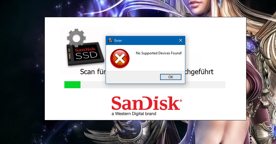

Dashbord 2.3.1.0 not finding my SSD
after updating from version 1.4.4.4 to 2.3.1.0 Dashboard aborts its start with the Message that no supported Device was found.

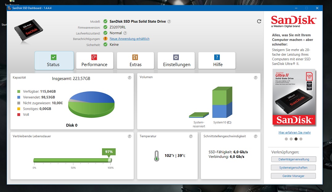

In the version 1.4.4.4 it finds it just fine…

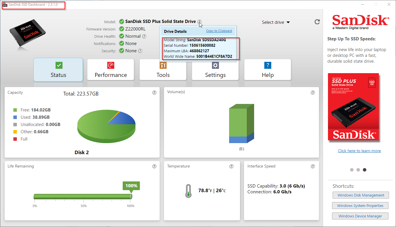

My drive is detected by 2.3.1.0 and it looks the same as yours.
Could the Firmware making the difference, my Firmware is Z32070RL your is Z22000RL.

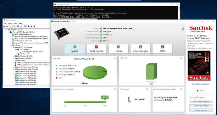

I saw that the new 2.3.2.4 did not fix your issue and more information was provided.  It seems that you are running with the ports set to IDE in the BIOS, is this correct? Is there a reason that you have this set up this way? What port on the motherboard is your boot device plugged into and how is it set in the motherboard, (IDE, AHCI, or RAID)?  The first 4 can be set up differently than the last 4.  Have you tried switching to the latest Windows drivers for this controller?
I switch the driver in one of my systems to AMD (latest version), it is not the boot device, but the motherboard is the same and and I using a IDE controller.  I had the same results when it was in AHCI mode and under the AMD SATA Controller.

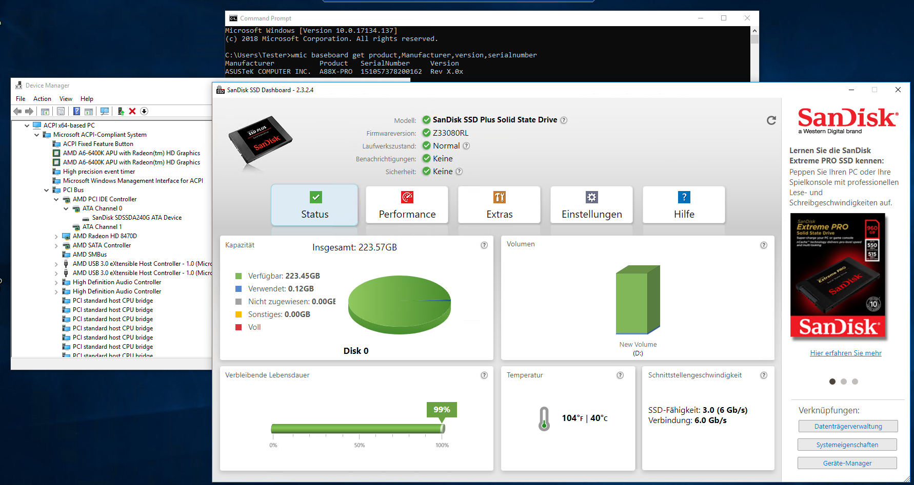

If I see the picture correctly, then your SSD runs in IDE mode on the AMD PCI IDE Controller Port 0 and not the  AMD SATA Controller.
I only see the AMD PCI IDE Controler when I set Ports to IDE.
I suspect that that Port 5,6, ESATA 7,8 are set to IDE an your SSD is connetetd to SATA port 5 (IDE port 0), Please check and try with these Ports set to AHCI.
