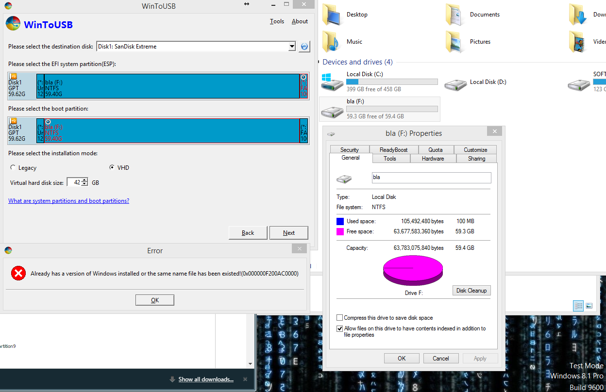

Used the testmode command and ran the .bat as admin, and got this error.
Solved it by partitioning the drive like this
solution
I realized my error of not reading documentation, GPT obviously didn’t work. Created 60GB NTFS part under MBR and installing it atm, I assume that will work so thanks for help
